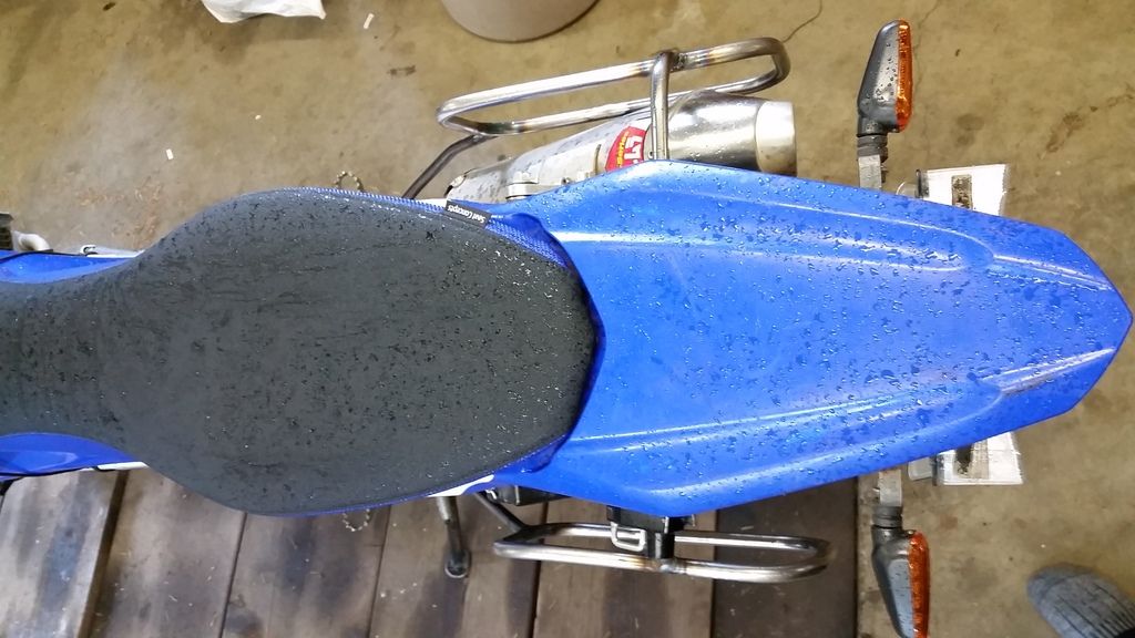

On the back I am making some saddle bag racks. I am trying to spend under $140 for the whole setup including racks and bags. I but some 1/2" OD (.060" wall thickness) tubing from metal supermarket. I got much more than I needed 20 feet cost me $30 after tax.
I got a simple hand bender, this one was a bit expensive only because I didn't want to drive to Princess Auto. This is basically what I bought.
http://www.princessauto.com/en/detail/1-2-in-tubing-bender/A-p8161002e
The tab that holds the tube at the beginning of the mandrel is a bit weak. If you are worried about it put a hose clamp around the tube and the handle to take some of the stress away from this tab. I mounted the bender in my vice as it takes alot of effort to bend the tube.
Because of the way this tube bender is setup you cant do a perfect closed loop. You have to offset your bends at an angle, this is no problem you can bend it straight again after.
Once I made the hoop it looked like this.
Simply put it on the ground and stood on it to compress it all. After cutting it at the overlap and doing some manual fine adjustments with the bends it looks like this.
It is not perfect but good enough for my first try. I made two copies of this, since I was too lazy to go back inside and grab my drawing I just eyeballed these. The two aren't perfectly the same, one is about a half inch wider than the first since but once its on the bike no body will notice.

Here is where I am at so far. Got better straps for the tank bag. Got the rear brackets fabbed up. I wont put the progress pictures in unless someone wants them. Looks like my post was caught up in the moderators for a few days. Also added a new seat concepts seat to the bike which makes a world of a difference.
so far on the rear rack i am about $30 bucks into it. I had bought way more tubing than I actually needed so I am not counting that.

Nice, but I'm wondering if the rack mounting is strong enough?
Many have 3 or 4 mounting locations or triangulation of mounts to prevent movement and cracks far from home.

I just used a cheapo mig welder to weld it all up. It is pretty small material so it doesn't take much to get good heat into it.

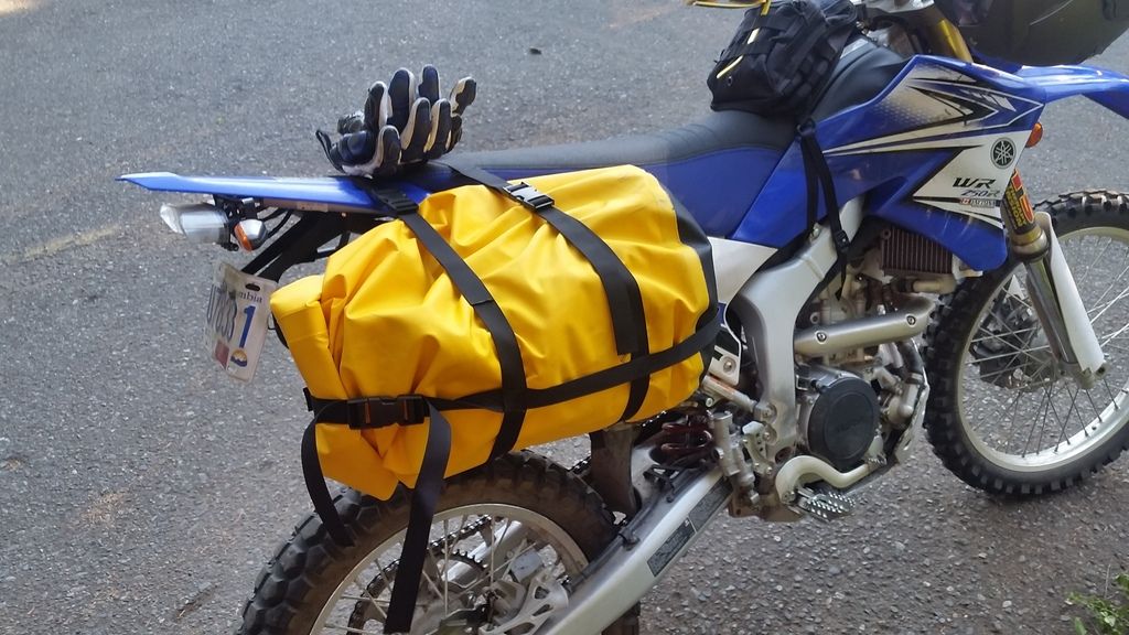

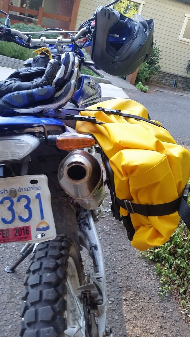

I guess I should finish this thread. Anyways after a few months I finally finished this and have something that works. I ordered some nylon straps online, some clips, loops and other odds and ends from an online source over on the east coast. I sewed the nylon straps into a bit of a cargo net. I also tacked a thin sheet of steel on the exhaust side loop so that the bag doesn't get pushed through and touch the exhaust. Here are some pictures. It is close but does not touch and does not melt. Also the dry bag I have used is the largest one I could find. I couldn't find enough stuff to fill it that is why it looks pretty limp right now. I don't have my actual dollar figure for the build but I would say it will be $120 once I get a second bag. It might not be the fanciest but everything is trailer repairable. If I drop the bike I wont damage a $400 wolfman drybag, I can just go to the local Walmart and pick up a new $30 bag to keep my stuff dry. The bag in the picture had about 25lbs of tow straps and chain in it. With the straps cinched up it is rock solid and does not move even offroad. Now I gotta use the left over metal tubing to make a tail rack so I can put a duffel bag across the back.
Here are the pics :
