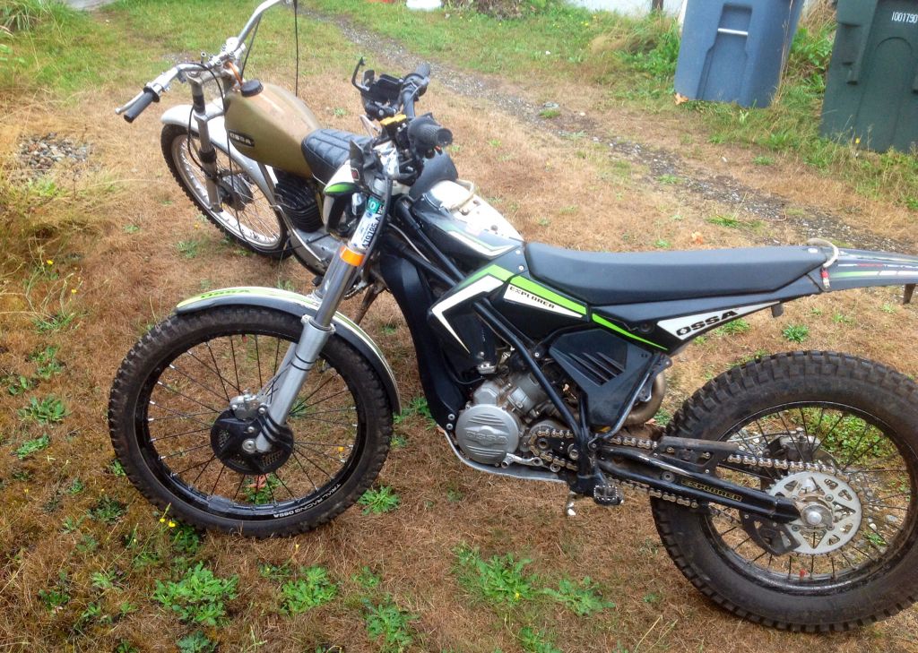

Here are a couple of pics
I've ditched the stock mirrors and installed dual star ones
