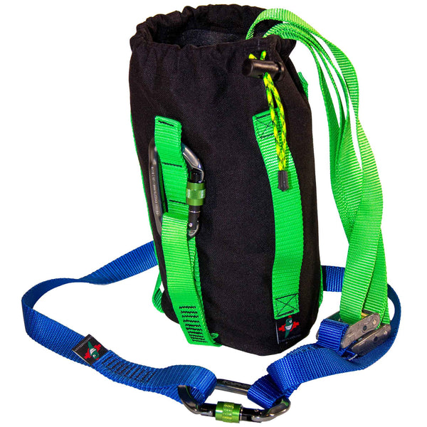

Not to take away from your expertise or ingenuity Russ but I came across this recently. It looks like the cost would be similar and it might be easier to put together and deploy for someone as brain-dead as myself;)
Rustic
DSBC President / BCORMA Director
Staff member
YES, the kits are good for novice use, all good.
